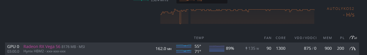

I"m using vega 56 .
These are my oc setting.
I’m getting this much hashrate however , it’s fluctuating. I"m using trm.

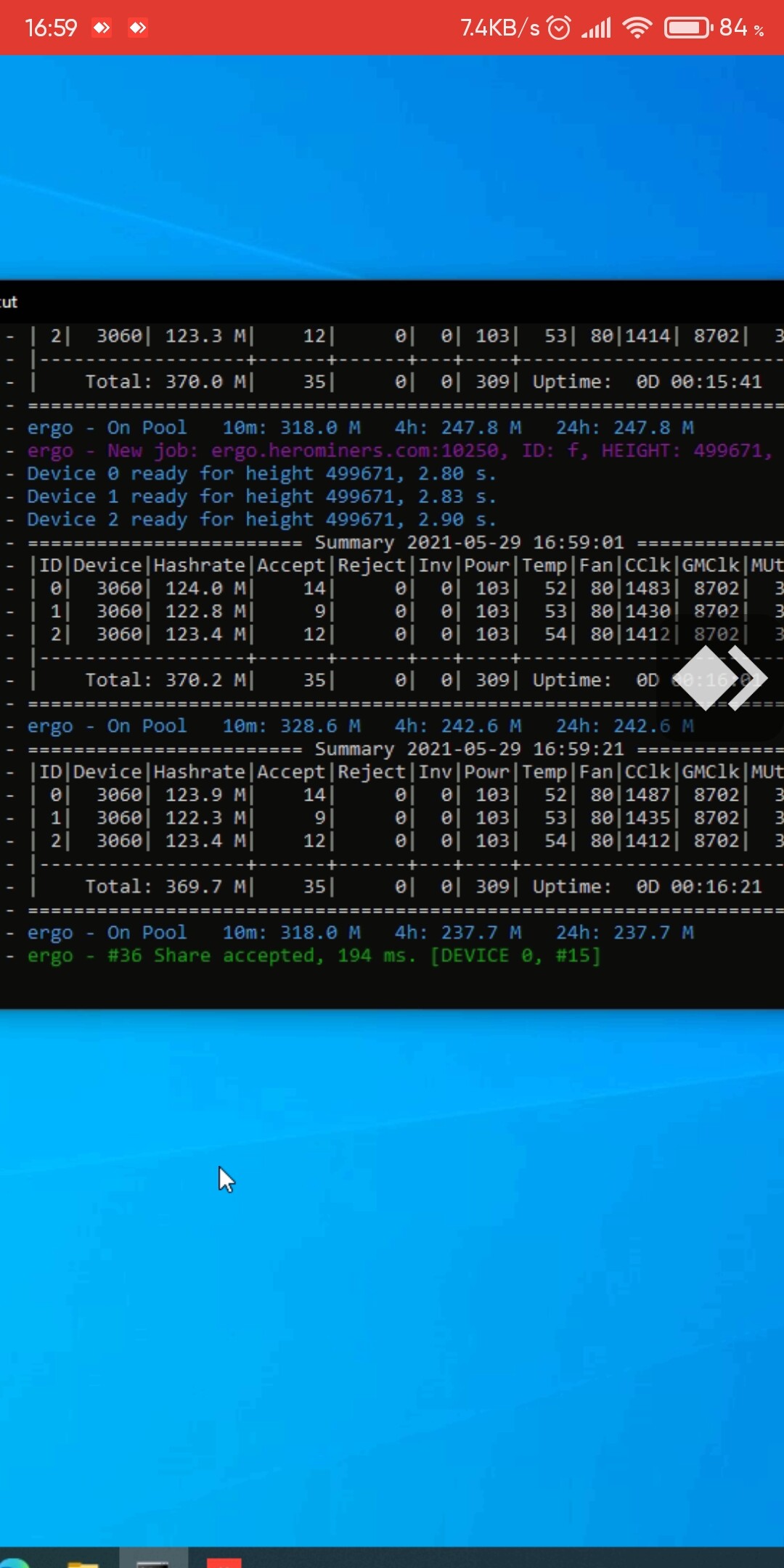

My new rig with 3x 3060 non Ti
