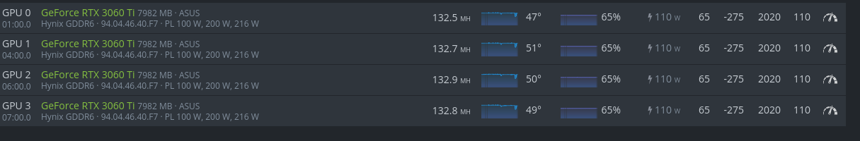

I’m not sure if MSI AB will let you lower the core clock that much, if so then -625. Lower the power limit until the miner shows consumption of 110 for the GPU. Memory clock: +1350
What miner are you using?
This is te best settings, u all can try this, and only what u need to chane is PL, bcs every card need different PL

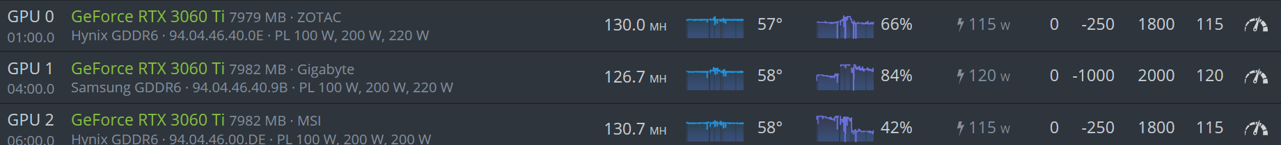

here’s the best i get for now (3 differens 3060ti lhr) :
not even 130 Mhs but close.
The gigabyte with samsung memory looks more ‘LHR’s’ than the two others with hynix memory.
Any suggestion of more tuning ?

have you tried core -1000, mem 2000, pl 120 ?
I’m using nbminer
better results also with your settings under T-rex
i suppose the 2Mh more you have is linked with your lowers temp.
(the gigabyte samsung memory one still a little behind, more tuning to do)

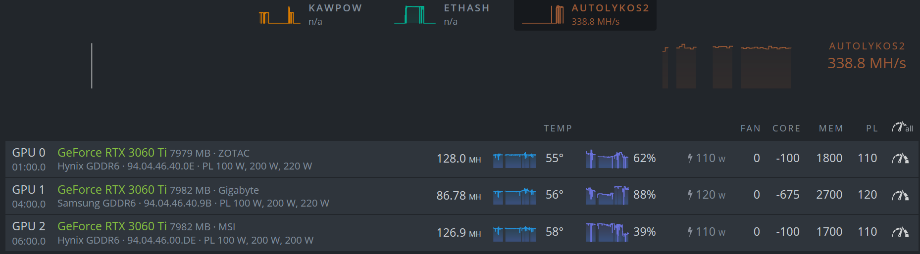

I’ve changed to T-Rex and reduced core slightly. Each GPU reacts differently. I’ve not tested different MEM settings.
