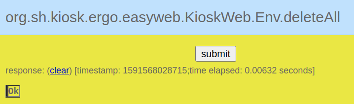

Step 1. Clear the existing environment variables

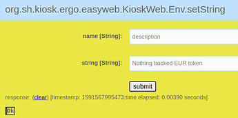

Step 2. Set the environment variables name, description and decimals as per the EIP. We will create a new token called EUR.
