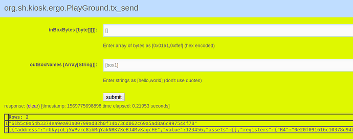

  1. Set the environment to use in ErgoScript. This is a map of (key, value) pairs where keys will be referenced within ErgoScript code and also for setting registers of boxes. See the first image.
  2. Define one or more boxes using ErgoScript code and some registers if needed. See the second image.
  3. Create and send a transaction with some given boxes defined earlier in Step 2. See the third image.
The final output will be txid of the transaction along with the request that was made to the Ergo node’s API.
