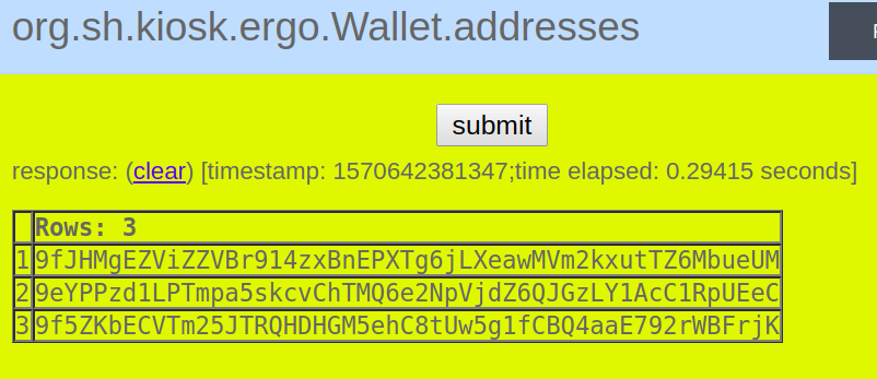

Here are the steps I used to create the transaction via Kiosk:
(Alice)
  1. Get (P2PK) address
  2. Get public key from P2PK address
  3. Set group element gX as with above public key in environment
  4. get default generator (g) by setting the exponent as 1
  5. Set default generator (g) in environment
  6. get full mix script hash using above environment variables
  7. update the environment with the above script hash
  8. Get the P2S address of Alice’s half-mix box
  9. Send transaction using the swagger API (can also be done via Kiosk)
