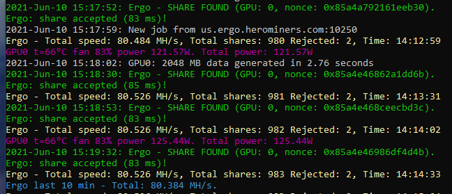

I currently have 2 machines that are mining Ergo via nanominer. (Herominers pool)
Machine 1 has a single RTX 2070 that gets about 80 mh/s consistently.
Machine 2 has two RTX 3070s that show about 337 mh/s consistently.
In the same amount of time (approx 14.5 hrs) that Machine 1 shows 1000 total shares found, Machine 2 will only show about 2000 total shares found. Shouldn’t this number be much higher? The mh/s is quadruple. What am I missing?
1x RTX 2070:
2x RTX 3070s:
