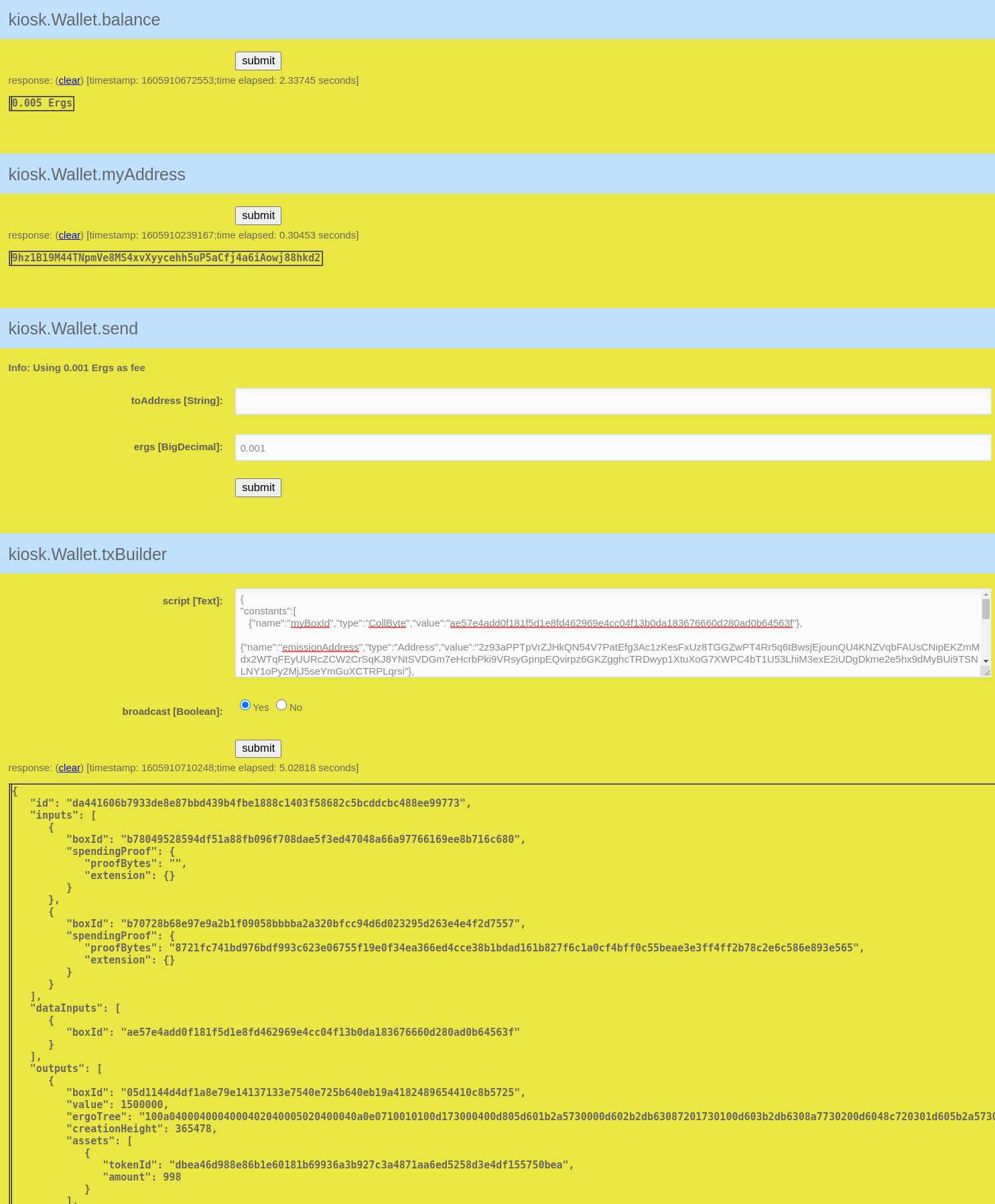

Using with KioskWallet
The above script was used to automatically generate this transaction using KioskWallet.
Please refer to the screenshot for details
