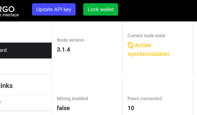

Check if the node is synced
While the node is syncing, the panel will show “Active synchronization” (see the image below).
After the node is fully synced, the text will change to “Node is synced”, as shown below.
