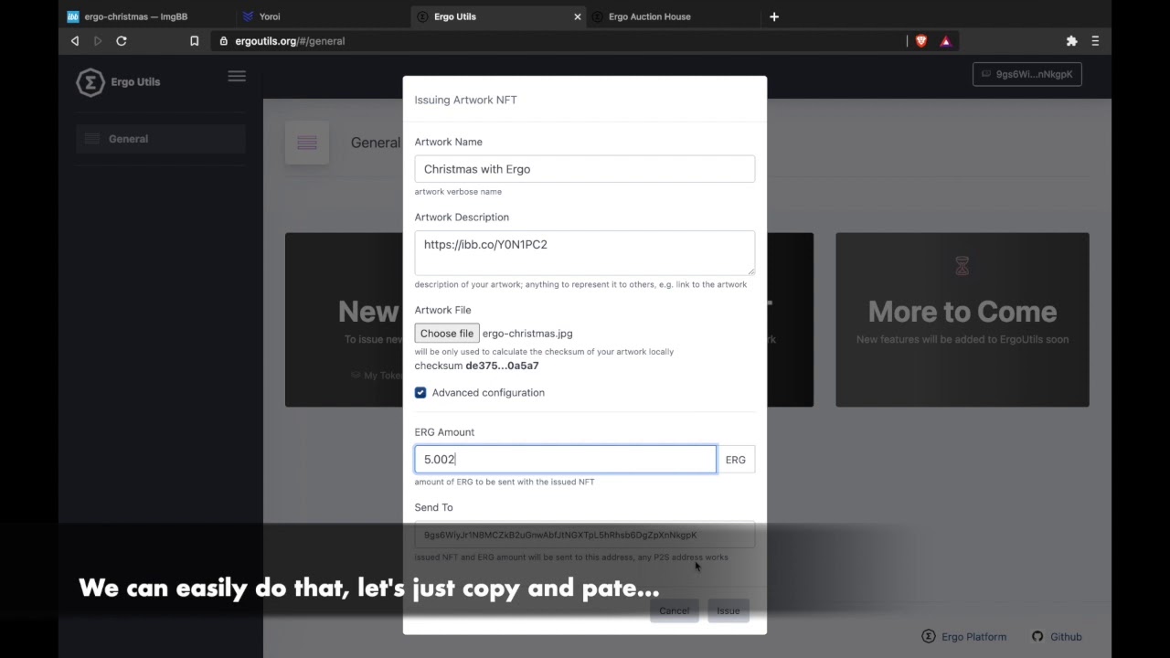

Trying to list an NFT using Yoroi wallet is there any instructions thanks. NFT is an image
Thanks, I’ll check out the video here is an example of my NFT. I am also going to work with an artist to bring a limited collection of NFT if I get success with my first ERGO collection I will create more. Is there any option to add an IPFS hash to the image within the auction for the winning bidder so that the higher-res images can be downloaded?
