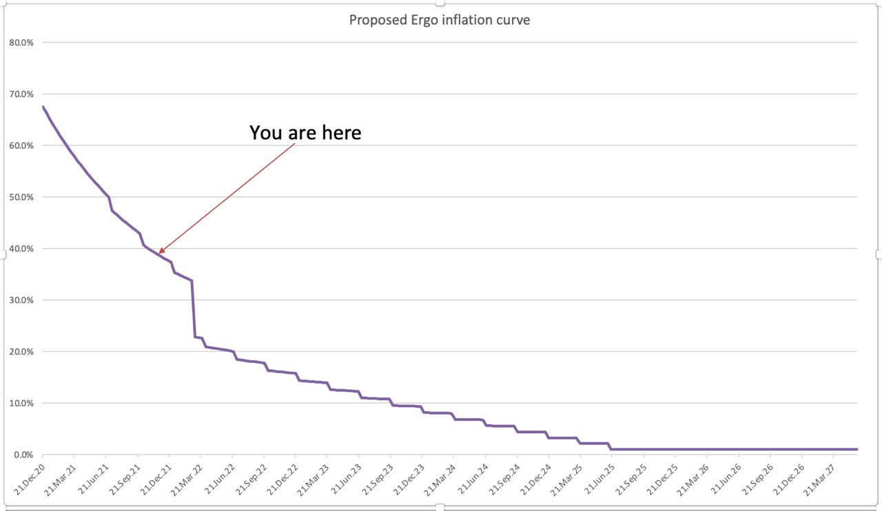

Do you have a graph that compare current emission vs proposed? Not 100% sure how this proposal is gonna affect current emission
Please see additional discussions here
Here’s a graph from Richi [MANA]
