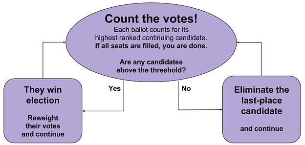

Ranked choice voting (IRV)
Voters rank their favorite option as first choice and then indicate their second and additional back-up choices in order of preference. Votes are counted in a series of rounds to ensure that as few votes as possible are wasted.
In each round, one of two things happen: either a winner is found, in which case all votes in excess of the requirement to win will be redistributed to each voter’s second choice, or no winner is found and the lowest voted candidate is removed, in which case those voter’s votes are redistributed to the next choice on their list.
The election threshold (how many votes required for victory) is determined mathematically based on the guarantee that that candidate can’t lose.
Eg: three candidates to be elected would make the winning threshold 25%, since if one candidate had more than 25% of the vote, it’s impossible for three other candidates to get more votes than them, because that would add up to more than 100% of the votes. With four candidates, it’s 20%, and 17% for 5, and so on.
Any candidates that exceed the election threshold will be elected that round. Any votes above that threshold go to the totals of the next candidate on those voter’s lists.
If no candidate has more votes than that threshold, the one with the fewest votes is removed and the next candidate on those voter’s lists is used in the next round of counting.
